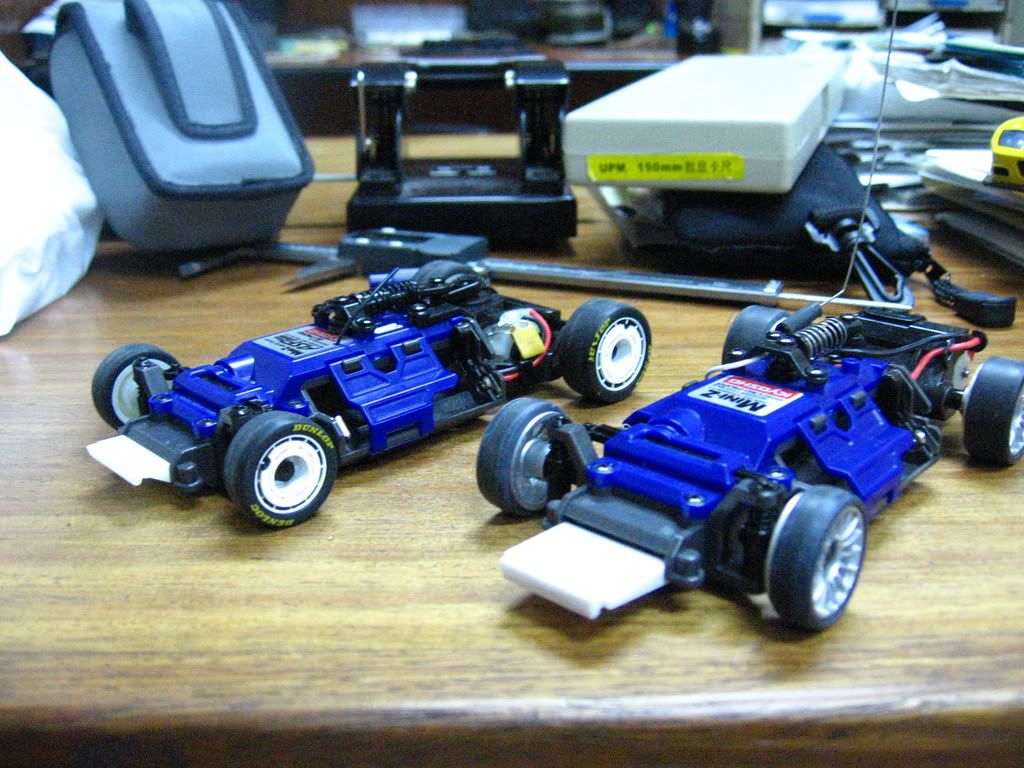

some comparative chassis pictures... stock mr02lm & stock mr02 rm (ferrari 575 - chosen because of it's wide front and rear track width)
front track width (lm on the left, 575 on the right) looks almost the same...
rear track width (lm on the left, 575 on the right) looks like the 575 seems a bit wider in the rear...
front comparison (lm on the left, 575 on the right)
note chassis is lower to the ground due to the lm knuckle - axle it placed towards the top, compared to the stock mr02 knuckle which is nearer to the center

Nice comparison pics Herman! Wait.... is that a caliber tool ? Were you at work when you took those pics !

and yes that is a digital caliper... measured the front track width of the mr02 lm chassis against the mr02... and well they're the same give or take a few .01 mm hehehe...
so i guess you can just swap out the motor mount and tada you've got a mr02 mm or mr02 rm... which is pretty good to know, since all the while i thought that the front track width of the mr02 lm would be a tad wider...
