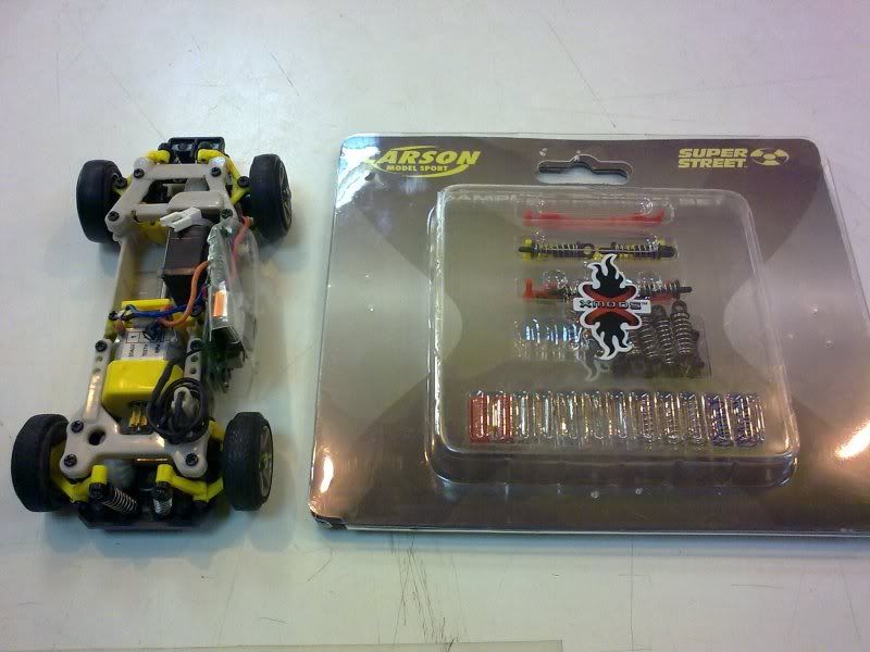

-Alloy dampers/springs! Completly bold tires
-Waxed the body! The look eats!
-Looked for this rear, and don't like it...
The bodykit! To Drop some mm the body...
-An mit evo aileron come in...very easy to put... glue the right amount of glue, and 2 screws to make it firm! And Sexy black rims!
