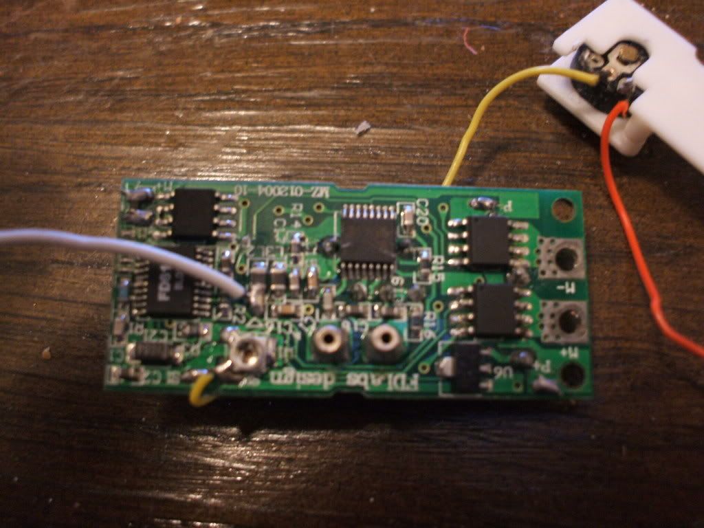

the drive fets on the iw ep are on the right of this pic

mk2kompressor,
The picture that you have posted is Firelap and not iwaver.
Ninja is right about the FET is for motor control only since the iwaver 02M has independent servo to regulate the control.
